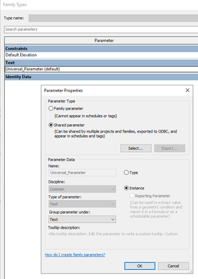

To assist you I did the following test:
  • created an Electrical Fixture family with a cylinder, called it Nested_Circle
  • created in that family a shared parameter which I called Universal_Parameter
  • set the family as Shared
  • repeated the above with another family, this one with a cuboid and called Nested_Square
  • loaded the same shared parameter (Universal_Parameter) into that family and made the family Shared
  • created another electrical fixture family which I called Host
  • loaded each of the nested families into the Host and placed an instance of each.
  • created two shared parameters, one called Parameter_Circle and the other called Parameter_Square
  • selected the placed instance of the nested circle family and associated its Universal_Parameter to the Parameter_Circle
  • selected the placed instance of the nested square family and associated its Universal_Parameter to the Parameter_Square
  • loaded the Host family into a project.
  • now when you select the Host family you can edit the Parameter_Circle and Parameter_Square in the Host without having to select the nested families - so you can use a window selection or use Select All Instances...
  • made one of the parameters X and the other Y
  • The different values now appear under the Universal_Parameter in the schedule
  • and can be tagged by loading the shared parameter into a tag family and using tab-select to tag the nested component
  • this example uses Instance parameters but you could use Type parameters if you want all instances of a family to have the same value, rather than having to select all instances and changing an Instance parameter.
Hope that helps.
