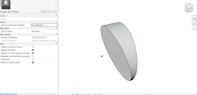

Hello guys do you know how to change familiies settings properties so I can pick the duct when trying to select a new host and it automatically close the system?At this time I modified an old family created from air terminal, but maybe starting from its mistakes form It cannot select any duct.
Hope to hear from you soon
Best regards and thank you for your patience.
Lorenzo

Can you attach the family so I can review it?

Of course, here one (generic) is the one I found already within MEPCOntent website, but it doesn't wor apparently to me. THe second (" Fresh air") I reversed the reference plan up to with was associated the extrusion but still doesn't hit the duct face and do not rotate as proper duct fittings when uploaded.
Thank you for your time @dbutts7

Looks like you dont have a Duct Connector in the family. (Doesnt show the (+) connector point in either view). Place a round duct connector on the back face of the family and set it to Supply, Out, Preset, with Diameter parameter linked to the diameter of the grille.
