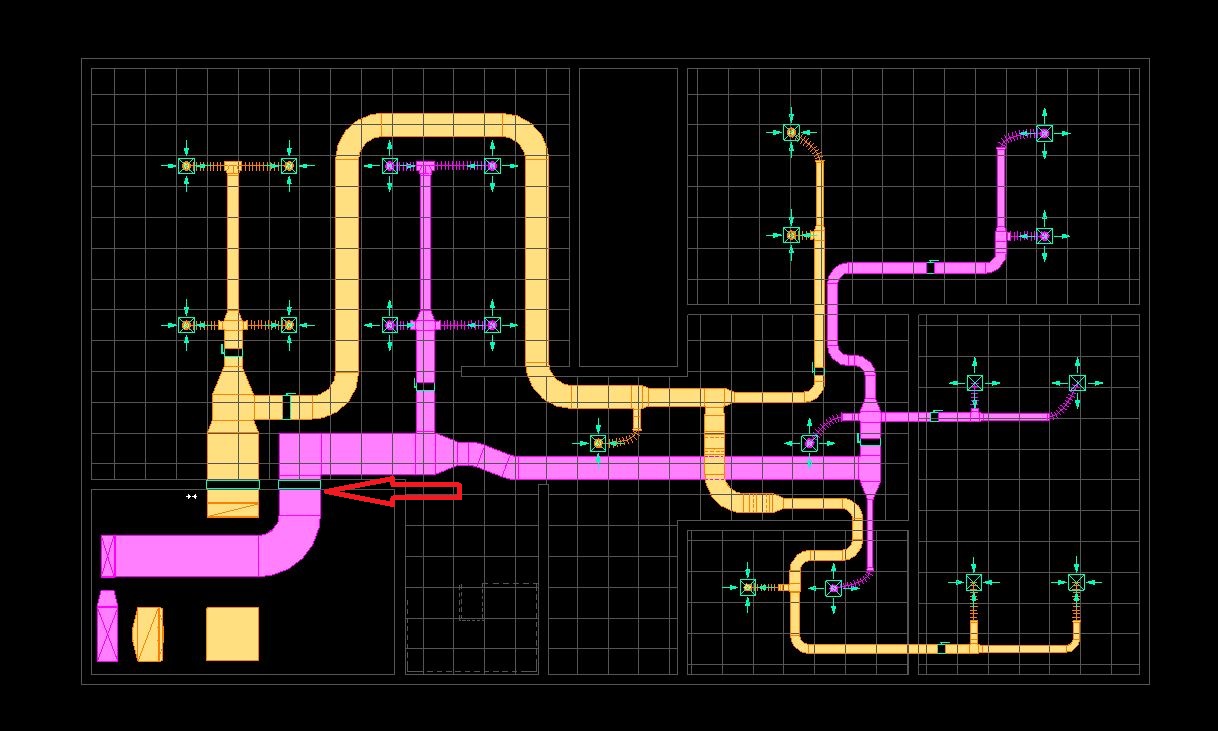

marco.defina
Thank you, i tried and work fine.
Only a problem, it's possible to differentiate color between Fire Damper and a Balancing Damper? They are on the same type "accessories for duct"
For Example the damper indicated with red arrow i will in red.

CoreyDaun
-Marco- wrote:
"Only a problem, it's possible to differentiate color between Fire Damper and a Balancing Damper? They are on the same type "accessories for duct"
For Example the damper indicated with red arrow i will in red."
You will have to create separate View Filters that affect each specific Family Type under Filter Rules and place those on the top of the View Filter list in the View.
