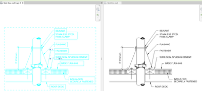

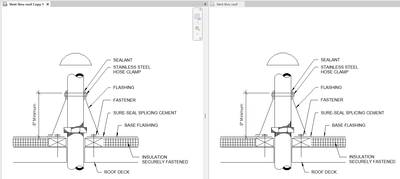

iainsavage
@micah  schrieb:
I would ideally like to have the duplicate
detail be dependent so I could edit one copy and the duplicate would
reflect those changes as well.
Once you've created your detail you can make into a group.
Editing one instance of the group will also edit all other instances.

rmc9WR3X
One thing that is not replicated in the parent of a Dependent view (in Revit 2020) is the position of the tag for a call-out. If you move the handle in the child the handle in the parent view will not be moved.
