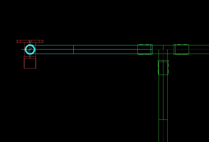

Hi there,
The built in revit MEP domestic water flowing parameters works based on Fixture units and flow.
Here in the netherlands we work with Tap eenheden, its basicly the same as fixture units but the values are different.
I made a family off an wallplate (since all our instllations end there) and made a new parameter called TE. then made entered a formula so it projects the flow, see the picture below;
this works, but when i use the system inspector it only projects the flow. I want to project the flow & TE instead of the Flow & FU.
I also want to make the TE flow through te piping system just like the Flow and Fixture units would. but the parameter TE (wich is a shared project parameter) comes up empty. it only projects the value on the wallplates
On the wall plate family:
On the pipe / fittings:
As i said before i want the TE to automaticly add up and let the parameter "flow" throught the system.
Hope someone can help me out.
Thanks in advance!

I don't think you can alter the behaviour of the System Inspector, its hard coded in the software.
As regards your TE method, that won't work either since you can't pass the values through the pipe network.
The only option, as far as I am aware, is to learn some programming and create your own addin calculator to use for  plumbing calculations instead of the built-in International Plumbing Code method.
There used to be an addin from Intelika which used Danish(?) fixture unit values and conversion graphs but it was discontinued in 2019 I think.
I've seen a UK consulting engineer who had there own version based on UK methods but I think they only used it in-house.
There are several posts on this topic already and in one or two of them there is a link to @jeremytammik 's Building Coder website describing how to create your own addin. I've never done so.
Not being a programmer the best that I could do was to tweak the IPC FU values to get flowrates which approximated to what I would have got if I had a UK version calculator.
Note though that the IPC method imposes minimum flowrates for systems at 15 USgpm for systems set to "predominantly flush valves" or 5(?) USgpm for systems set to "predominantly flush tanks".
