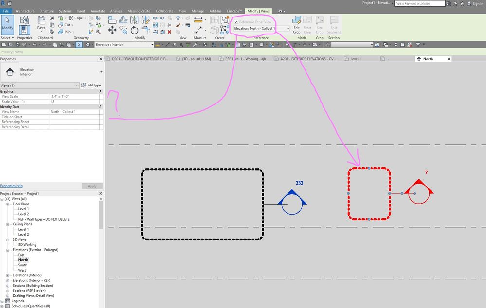

_andyman
Annotation 2019-02-28 133559.jpgThis hack still does not work for referenced views. The shared parameter does not get applied to a referenced view. This can still not be done. In the attached photo i added the shared parameters using the hack and labeled the original view as '333'. I then referenced that same view as a new callout (highlighted in red). You'll notice that the shared parameter isn't there.
