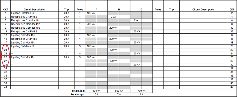

From the original post:  " if I enter 16 into the max # of one-pole breakers, ....  However, I cannot circuit 16 3-phase loads. "
This is the designed behavior... you'd be able to connect 16 one-pole loads, or 5 (16/3) three phase loads (leaving room for an additional 1-pole load)... or some other combination totaling 16.
" I have two panels circuited to the switchboard, and I would like to circuit six or seven more 3-phase loads along with a couple of 1-phase loads.  On a switchboard, this should only take up 10 or 11 slots, so 16 should have room for spares. "
Assuming the two panels are 3-phase, you are trying to connect 7 more 3-phase loads, that is a total of 9 three phase loads, requiring 27 breaker slots... so you'd need to set 'Max # 1 Pole Breakers' to at least 27.

@Martin__Schmid, I think that would solve the problem.  However, I think that workflow would be confusing, especially to new users.  Ideally, I would like a "Number of Schedule Rows" parameter that would allow the user to set the number of circuit breakers/spaces installed into it, whether 1, 2, or 3 pole.  This would be in lieu of the "Max # 1 Pole Breakers" (only for switchboards; branch panels work properly).  This is a typical workflow that most electrical engineers are used to in other panel schedule programs, and seeing the rows disappear as multi-pole circuits are added would most likely confuse & concern them.
Both solutions would resolve the main issue with the design, though - if the user has multi-pole circuits on a switchboard, it creates unusable rows that take up space on the sheet.

A few things that I do not see mentioned which may better answer your question about current workaround are as follows:
"This is the designed behavior... you'd be able to connect 16 one-pole loads, or 5 (16/3) three phase loads (leaving room for an additional 1-pole load)... or some other combination totaling 16."
In this scenario the panel schedule being set to "Variable based on maximum number of one-pole breakers" would have the resulting number of available slots show as 16 in the switchboard panel schedule. 5 of which would be labeled and the resulting 11 would "display" as empty to the unknowing eye.
"Assuming the two panels are 3-phase, you are trying to connect 7 more 3-phase loads, that is a total of 9 three phase loads, requiring 27 breaker slots... so you'd need to set 'Max # 1 Pole Breakers' to at least 27."
In this scenario the same displayed results of 27 slots will show on the schedule but again seemingly show 18 of those as empty slots to the unknowing eye.
Now to answer the question of the current workaround (at least the best one found to date). In order to show only the labeled slots and not the blank slots:
  1. we have the schedule itself set to "Variable based on maximum number of one-pole breakers"
  2. Set the Distribution Panel "Max #1 Pole Breakers" to match the number of connected labeled slots. Our examples above would be 5 in the 1st example and 9 in the 2nd example. To continue with this example I will use 5 connected 3 phase loads.
  3. At this point we are displaying only what we need displayed (5 slots) in the schedule with no great difficulty. Adding an additional 3 phase load at this point is tricky. Since we have the "Max #1 Pole Breakers" set to 5 to match the desired number of labeled slots we need to modify the setting before connecting additional load.
  4. Next step is to change "Max #1 Pole Breakers" to 0 (explanation of why "0" to follow).
  5. Now we can connect the additional 3 phase load.
  6. Increase "Max #1 Pole Breakers" to 6.
The result is that you now have you panel displaying a single slot per connected 3 phase load. In step 4 if we were to increase the "Max #1 Pole Breakers" to 18 (6*3) we could also connect without error but we could not at that point reduce the number of "Max #1 Pole Breakers" back down to 6 without requiring disconnect. This is a specific one way street that only works in a very specific and unclear manor.
Hope this clearly describes both what we are being required to show from our Engineers as well as the difficulty in having to achieve these results.
