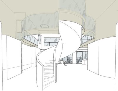

I currently use a blend for this which allows for both the top and bottom of the wall to be sloped if needed.
Having this feature using a curved wall would be much easier.
Some may say why don't you use a stringer for this application..
Well if you have ever tried to use a stringer you will soon find out that they are flawed when it comes to curves.
