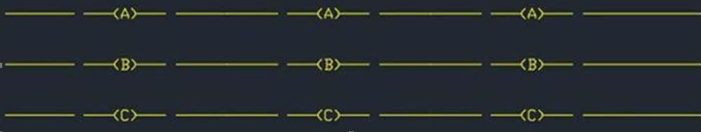

In Revit the  lines types you can have is really pathetic compared to AutoCADs - dashes, dots and continious lines. (And the ofcourse the Insulation that has its own button to make, and the revision cloud if that counts...). Would be very helpful to be able to make various line types with shapes in 2d - like tracks, talus and I thing that was already suggested - with text in it. Out from deperation (again) we are using detail line family with text in it to display  ELEC, HYDRO, Xs (for fence), etc... but comes a curve and there the solution stops. We are also forced to do untinkable things to a surveyors drawings in order to preserve their line types in Revit.

I would do anything to have CAD linetypes in Revit, Electrically we used linetypes with Text to denote different services on drawings, now we resort to printing in colour (which has major flaws if printed in black and white) or a series of dashes and dots which is ridiculously confusing and impractical, I would love to have the ability to just had a few characters of text between a solid line.

As electrical and plumbing, we need text in our linetypes. It seems like it would be possible to add "text" to the options of "dot" "dash" and "gap" on the line pattern options. With adding text characters, it would be possible to approximate many complex line types as well. Imagine ASCII art linetypes.

@NateBrush To be able to add text to linetypes wouldn't be as simple as just having a "text" option in the definition dialog - you'd still need to specify Size, Font, Width, etc. (unless there's a project-wide setting, but that would be limiting). Maybe the "Complex Linetypes" solution would allow you to "draw" text, or maybe having an "Annotation" option (instead of "Text") would allow the inclusion of Text AND other things (complex lines)?
NateBrush
Not that it would be easy to add text, but it seems like the most straightforward way to add it to the existing interface (and probably rendering code, but that's beyond my skill). Users could specify text type from their existing created types then enter the text string. Then the program could render lines, dots, dashes, and strings.
But adding more complex lines and shapes would be great, for all the reasons everyone listed above. Hopefully they pick this one up soon!

To better represent civil information, how about adding text to line types or system line types that are respectful to civil?
E.G.
- - - x - - - x - - -
or
- - - STMW - - - STMW
kushal007
You can do that by creating new pat file coding for line patterns i guess.
samuelsanf
- - - GAS - - -
