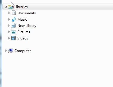

Not sure if this is the correct location for this post.
I downloaded the new Desktop Connector today from the blog posted here...
https://projectdelivery.autodesk.com/blog/desktop-connector/
Installed it, and rebooted when prompted.  Now, my "Computer" is completely broken.  I cannot browse anywhere on my machine without providing an actual address.  The shortcuts are all broken.  Additionally, i am unable to access files on the Revit Server.
My cpu will spin, thinking endlessly.
When trying to reboot, it will not close the Desktop Connector application.  So i have to force close the app to reboot my machine.

Another Update...This program is very broken for me.  It is unfortunate because it seems so promising.
I tried to install the Desktop Connector again this morning because my colleague has it up and running.  Same problem as yesterday.
when Desktop Connector comes up, it will initialize services for a while.  Then, i have the ability to sign in/out, but at that point all access to my C Drive and Revit Server become broken.  If i kill the application, things will come back (uninstall works as well).
I didn't see anywhere on the blog post where i could contact the author, leave feedback or ask questions.  So if anyone from that factory is out there, i would love to find out what is causing this issue and how it can be fixed.

nbower
***Update***
I logged into my machine as another user.  The user profile i used has the Connector install correctly on his machine without issue.  Unfortunately, the program still does not work properly.  The same issues persist.
So it looks to be something specific to my machine.  More specifically it looks to be something very specific to creating the virtual drive under 'Computer'.  I am able to browse to the various folders under the library shortcuts, but not the Computer.
I uninstalled again so I can get back to being able to work....

nbower
@michael_coviello, the Desktop Connector does not work at all on my machine.  Once is it installed, the ability to browse to the 'Computer' is broken completely.  I only referenced the term virtual drive, because that is what i am assuming Desktop Connector uses/creates in the 'Computer' section.  My apologies for confusing language.  I do not have any virtual drives on my machine currently.
My C: Drive is a physical Solid State drive on my machine.  For reference this is what my 'Computer' looks like without Desktop Connector installed (see image below).  Perhaps if i get more time this afternoon i will do a screencast to show exactly what is happening.
