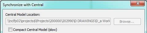

Has there been a change in how Revit uses UNC patht in Central files? In 2014 and prior the central files always used the UNC-path when it was saved to a network drive, even if we have browsed via the mapped drive path. In 2015 we discovered that Revit uses the mapped drive path. Since we have a couple of offices whitch all have same drive letters mapped to different servers and we work in projects on other offices, it doesn't work so well in 2015. We have to make sure that the projects alwaty uses the UNC-path when they save their central models.
From 2014
From 2015
Any other who have experienced this?

Take look at the images in the first post. That is how it looks like for us. They show central models created exactly the same way in both 2014 and 2015, browsed via the mapped drive (in that case Z:\).
In 2014 when we save our central models, even if we browse via the mapped drive, the central model shows the UNC path for the Central Model Location. In 2015 it doesn't work like that. The central model shows the mapped drive path for the Central Model Location.

Ok I can confirm that 2015 is doing something differently so you are not crazy, at least not about this. In chatting with a friend about it we suspect this may have something to do with the recent development of A360 and Collaboration for Revit (C4R). That's probably why Autodesk has replied, they realized that something internal may be involved.
Fwiw, I find that I can get Revit to focus on the UNC path, as it should, if I use the Browse option in the Synchronize with Central dialog and select the file via the shared path instead of the drive letter path. It is important to do that before any users get into the project though. I'd be interested to see if you can get it corrected this way too.
Edited: Okay, I was logged into A360 during my testing. When I logged out of A360 I got the UNC path saved as I expected. It seems to be important to make sure you are not logged into A360 when you create a central file that won't be used with that service.

I find that Revit 2015 is sensitive to how the path is established. Disregard my A360 comments added to the previous reply, it doesn't seem to factor into the following observations.
Saving the File to Create the Central File:
via My Computer and selecting the mapped Drive letter: Revit stores the drive letter path (wrong, not desired result)
via My Network and selecting the shared resource: Revit stores the UNC path (correct desired result)
via My Computer > manually typing in the shared resource name (for example: \\MyServer\Projects): Revit stores the UNC path (correct desired result)

Much as described in the very first post, this behavior change in the 2015 release has already been reported, and identified as needing correction, to behave back as it was in previous releases. Plans are to have this corrected in the upcoming release.
