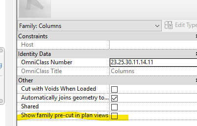

I've been using the attached timber column family from the Revit library (first time using it). In my model I'm assigning it a wood material that has one hatch for surface pattern and a different hatch for cut pattern. But in plan/RCP where the plan view cuts through the column I see the surface pattern.
I tried cutting a vertical section directly through the column and noticed that the cut pattern is working there. Does
Revit not recognize plan cuts as horizontally-oriented sections? Is there a way to get this column hatch to read as sectioned through without doing a bunch of annotative regions?

I'm not sure what you are seeing, but your Column displays Surface and Cut Patterns correctly for me.
...I wondering if the post I deleted might actually have been on point.  Pre-Cut vs. Not Pre-Cut  Behavior?
https://knowledge.autodesk.com/support/revit-products/learn-explore/caas/CloudHelp/cloudhelp/2018/EN...
Still, I can't seem to replicate what you are describing. I tried on 2019.2.

Try the revised one attached below.

@Anonymous : View Visibility/Graphic Override. Final answer.  Smiley Wink
Message 7 of 8
in reply to: barthbradley
Yep that was the problem, someone did graphic overrides in view. I thought I checked that when I was going through the problem the first time but I obviously missed something. Thanks for the help!
