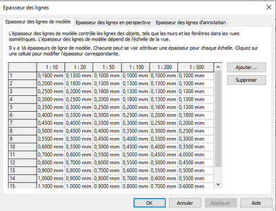

malot
HELLO
To manage these line thicknesses, you need to go to the "Manage" tab, then "Additional settings" and "Line thicknesses". Manage the line thicknesses according to their scale. For walls, this must be done in "Model line thicknesses".
Once this is done, you need to go to "replacement model V/G". If there is no active template, the default shortcut is "VV".
If there is a template, open the template and then go to "replacement model V/G".
Once the dialog box is open, click on "replace host layers" and then modify them according to the thickness values you want.
