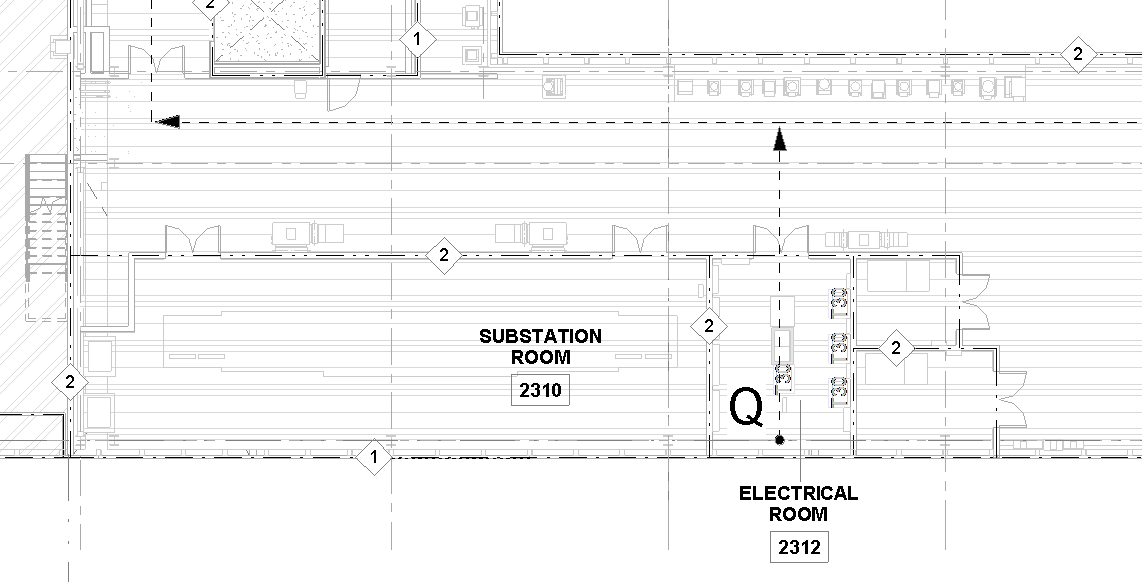

Hello! Hopefully someone can help me...
When I print the second story of my building to PDF from Revit, white ghosts of elements on the ground floor (walls and equipment) show up through the room color scheme hatch. The ghosts aren't visable at all in Revit, only when I print to PDF. I checked the second floor rooms and their level is correct and their base offset is at 0'-0" so the room color scheme hatch couldn't be cutting through the elements below.
Revit Without Ghosts:
PDF With Ghosts:
927 Views
dzanta
change your color scheme from background to foreground in the properties palette.
Dzan Ta, AEE, ASM, ACI.
Autodesk Community | Twitter | YouTube | Facebook | LinkedIn |
Win 11 Pro/DELL XPS 15 9510/i9 3.2GHz/32GB RAM/Nvidia RTX 3050Ti/1TB PCIe SSD/4K 15.4" Non-Touch Display
This works, but I'd like to continue to see equipment / walls on top of hatch instead of the hatch covering everything...
