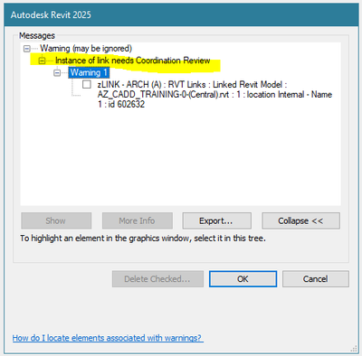

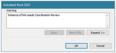

One more thing i wanted to add 😁.... IF a monitored element is modified, you will get a Coordination Review warning when you open your model. Most people just close the window, but if you pick the expand button, it will tell you what model the copy monitored elements related to that model came from.

That's interesting, I can't ever remember getting a Coordination Review message and not being able to expand it and see the originating model. But you are correct, it doesn't help for on-demand situations.
@RSomppi , I see this happen all the time. Usually, the staff that did the copy/monitor wasn't paying attention and CM'd a Grid/level from one of the other linked files. When I find those, I usually recommend doing a Stop Monitoring and then reMonitor to the appropriate link element.
