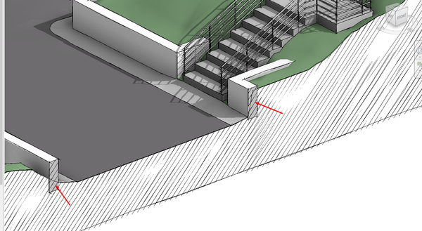

I am investigating how I can have walls pushing away the terrain. I know you could use building pads underneath each wall but what if the wall is made of a profile. What if there are multiple levels.
Are there other options to cut away toposurface?

As long as it remains a Toposurface, your options are limited to pads, grading and subregions. The poch representation displayed by Revit is not a solid form which can be cut in sense of cutting a geometry
Options are as follows using dynamo:
  • convert it to a mass or generic component
  • convert it to a floor element with modified sub-elements
  • Convert it to a directshape cut by the wall geometry
Something cool would be a dynamoscript that create pads based on what I select (walls, stairs etc) and places them underneath each selected item, based on the selected items' Min Z elevation 🙄
  1. convert it to a mass or generic component
  2. convert it to a floor element with modified sub-elements
  3. Convert it to a directshape cut by the wall geometry
  1. Do you have any DYN-files or any like you could recommend? I searched but found nothing (maybe I was searching with the wrong keywords). I tried however to create a mass, but I couldn't cut a family to it, nor host a family on the mass. So I am really curious about this method.
  2. This worked for me 👍. I got a DYN file (provided in this post, if anyone else wants it). The floor can host families, of course, and you can cut through it. Walls can be joined and you can Switch Join Order, so that you can prevent what I showed in my previous screenshot.
  3. What does this mean, "directshape"?
