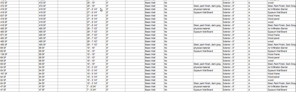

If I turn on "Itemize every instance" then it has multiple lines for each wall type...
2021-02-10 10_26_10-Autodesk Revit 2018.3 - [Schedule_ Wall Material Takeoff - N5668 2018-1.rvt].png
Any method to list all of the materials under one Mark Type entry?

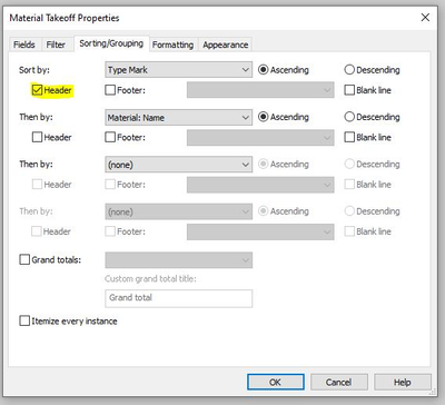

Don't know if you are looking for this type of look but here's an example of I have done in the past:
To do this you need to check the header button in the Sorting/Grouping tab in Schedule Properties:
Hope this helps.
