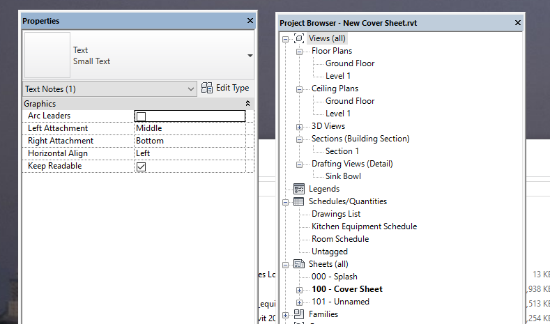

If you once set the visibility of the text to invisible... how can you change it to visible again? You dont even know that there is a text somewhere.
Message 17 of 17
This is helpful but for some reason the visibility option under properties - graphics - is not showing. It shows horizontal align and keep readable but not the visibility option to add the parameter.
Any reason why?
