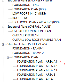

For ex.  you have your main floor plan (overall) make a duplicate with detailing or just duplicate. Then from the one that you just duplicate make your dependent view. This way you can apply a template you overall  and another you dependent views.

If you look at the pic. that Post it you will understand.  When you create a dependent view the template you have in main view is going to take over those dependent.  If you need to create other plan view in different scale with a different template you need to duplicated with detailing. this is the only way you can apply a different templates to your views.
  1. Foundation Overall.
  2.  foundation plan and all the dependents.
  3. Foundation plan Ramp - 1
  4. Foundation Plan ramp - 2
I have 3 templates of each. Foundation overall, foundation, and foundation ramp.)
