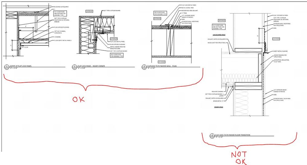

We're printing sheets of details and some views are printing as raster images instead of vector, leading to inconsistent graphics. We're getting the "Revit is going to use raster settings" warning box, but these details don't have shading, depth cueing, point clouds, gradients, or anything else that would typically trigger raster printing. I can't figure out what the issue is, as these views are all created the same way using the same view template.
Help! (Using Revit 2018, fyi)
Screenshots below:1.JPG

Ar those detail or drafting views?
Message 3 of 18
Detail views.  Also happening in some sections as well.
Message 4 of 18
One reason could be they were created as Section View and Depth Cue is enabled.  then later on, they were changed to Detail View, where Depth Cue is not available, but they still inherit the previous settings.  To check that, change a view to Section view and inspect all the Graphics settings.

Problem solved, thank you!
There must have been some inherited graphics settings from the section view.  I assumed that turning off depth cueing in the applied view template would have solved that, but it didn't.

Ok, so I just wanted to add to this for the benefit of everyone else who didn't understand it. Here are the that steps I did when I solved the problem I was having.
1.  Select view in Sheet, change the View Template to NONE from the Properties Bar.
2. Activate the View, change the Type from Detail View to Section View from the Properties Bar.
3. Click the Box Icon at the bottom panel and click "Graphics Display Button"
4. Change the settings that might be affecting the vector printing from here (transparency, gradient, etc.). For me it was the Depth Cueing ----it seems like this is checked off when the view is a Section type (might be aligned to what ToanDN mentioned).
5. Change the View to Detail View and then apply the correct View Template/
*note: It seems like there are some items in the view settings that even selecting a View Template will not prevent it from being overridden. Some settings remain in the non-template-ed "VV" settings of the view even when you apply a View Template to the view. Kind of similar to the cell settings in the schedules that the formatting remains the same even after a schedule template is applied to it.
