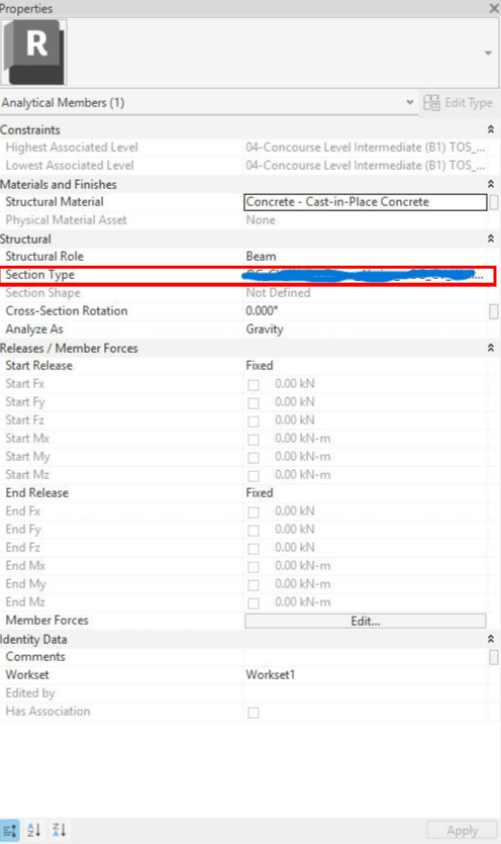

i have the same problem as your problem , its the Analytical members that are created with the beam , i think you tried to change the type of the elements you trying to change its family , Example :- you have rectangle beam family with messed parameters and you have adjusted a new family(another family) then you loaded it into project  , when you change the type the (section shape) built in parameter that appear when u select the analytical member is still assigned to the old one (see the Screen Shot ) if this doesnt work you can try these simple dynamo nodes that may help you find the elements by id(last node require package name (Modelical) .
