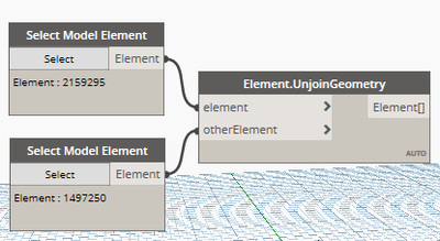

adrian_jTTKH5
I came across the same problem in Revit 2021:
This dynamo script solves it:
