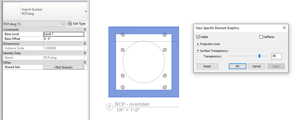

Right click on the DWG. Click on Override Graphics in View. and then Element.
Rina Sahay
Autodesk Expert Elite
Nachricht 15 von 22
MuirEng
als Antwort auf: Sahay_R
okay! That works. Thanks!

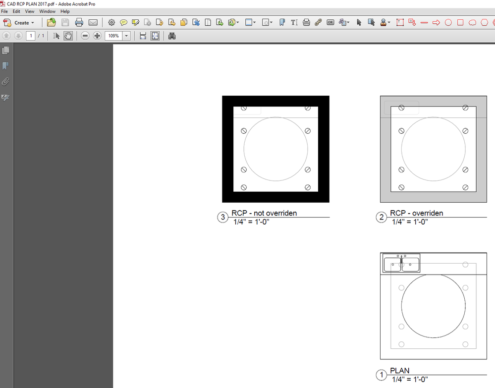

Hmm, I turns out that this solution works on screen but I cannot get this to translate to a matching PDF file.
I've attached a screen shot of my view and a the screen shot of PDF. I tried changing the colour of the hatch but that doesn't seem to help.
Ideas?

What are your PDF printing settings?  Mine comes out correctly.

I printed (via print command, not Bluebeam add-in button) with the settings below.  Attached is the PDF.  It looks okay.

Hi, I ran a test with all setting same as your second screen shot. No change in output. I don't find anywhere a screen like your first screenshot but I'll dig some more. But could this be some difference in my file vs your test file?
thanks again for the help
(I'm running Revit 2017 at the moment)
