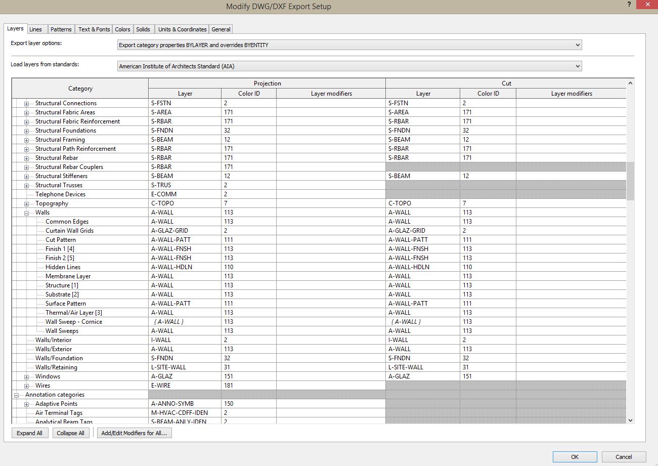

Hello everybody.
I am experiencing some troubles with assigning cad layers to different revit wall layers. There are 3 attached images to represent my problem.
Using the AIA Standard (image 1), layer Finish 1 will be exported as "A-WALL-FNSH". Seems like the user can assign his own cad layers to all the wall layers, depending on his needs.
The problem is that it actually doesn't work.
In fact, as you can see in the image 3, five lines in the exported cad file are picked and they are all the same "A-WALL" layer, while I expected to find the Finish 1 (image 2) wall layers assigned to the "A-WALL-FNSH" cad layer.
After several attempts, it seems to me that when exporting compound walls, the inner wall layers are assigned only to "Common Edges" cad layer, and the outer ones are assigned to "Walls", or "Walls/Interior-Exterior", making the other actually useless.
Does anyone know how to assign cad layer to all wall layers?

              In dwg export >> Modift setup >> Layers >> under Walls >> you can change the sub layers  Finish 1, finish2, thermal/insulation  to different layer names / colors etc... Pls check the attached print screen photo  ( Dwg setup)

Hi! Thanks for your answer.
Unfortunately this didn't work.
As I said before, I tried many times to change cad layers' names and colours, but the only layer which seems to work for inner wall layers when exporting compound walls is the one assigned to "Common Edges".
Anyways, I attached screenshots of the export settings (image 1) as adviced, and the results. Again, I find only "A-WALL" layer for every picked line in AutoCAD (image 3), and taking a look at the layers list only three wall-related layers appear (image 2), while I expected to find also "A-WALL-FNSH", "A-WALL-THERMAL", "A-WALL-BASE".
Is there anything else to try?

Pls make the adjustment of Export Layer options to  " Export all properties BYLAYER, and create new layers for overrides "    ( also added as attachment)

I am sending the revit file that i achieved to export wall layers seperately.. Also a print screen of Host layer line styles settings...
Nachricht 8 von 19
als Antwort auf: Anonymous
Host layer line styles...that's what makes all the difference..! i didn't know about it.
Now I have all the cad layers i want when i export.
Thanks a lot!
