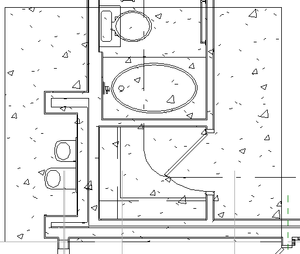

Why has Revit and LT 2019 done away with the transparency option on a filled region? I understand that it has been improved with foreground and background fill patterns but surely the opaque/transparency drop down should still be there? I have searched on here and there is a post regarding setting up a filter which I do not think is available in Revit LT? Any help would be appreciated. See photo of what I'm trying to produce (done on Revit LT 2018)  Transparency Filled Region.png

Are  you saying that LT doesn't allow you to control Surface Transparency through element Graphic Overrides?
Message 3 of 17
Thank you for your response which has worked. It is just a slightly different way of achieving the same result to what I did before in Revit LT 2018 and previous releases.

There was a slight change to the behavior here in 2019.  In previous releases there was a setting called "Background" in the type properties of the filled region. it was set to "Transparent" or "Opaque" depending on what you needed.
In 2019 the type property controlling this behavior was changed to "Masking" and it is a check box (on or off).  It was changed because it seemed weird to have 3 parameters with "Background" in the name and if left alone it might not be clear what the generic "Background" parameter would control, so it was changed to "Masking" with a check box.
Using this control on the type of filled region, you will be able to get the same effect as you did before.

In previous versions, it was a drop down in the Type Properties dialogue box. See image. Thanks to a subsequent post it looks as though it is still there but under the guise of 'masking'

I think folks are trying to mimic detail line behavior with filled regions (since FR's are easier to work with most often).  The above does not accomplish this as unchecking "masking" allows you to see what's below the region but it still masks in a color.
Besides overriding graphics in view (which - as per the first response, will work) the other workaround (closer to a solution I'd argue) we've done here is to create a drafting pattern of parallel lines (at either 0 or 90 degrees) at the max distance away from one another (10 feet I believe it is).  If you do this the lines are spaced so far apart that the pattern mimics a fully transparent filled region - the same look as what you used to be able to accomplish in Revit 2017 and before.

I choose the colour and turn down the saturation and ensure the masking checkbox is unchecked to avoid overriding the graphics in view, but its still not a true trans. I've drawn three filled regions to show 3 different Alfresco options but they still mask each other 😕 Objects are still able to be seen and they are not masked. Overriding the graphics in view transparency setting turns it into a true trans.
