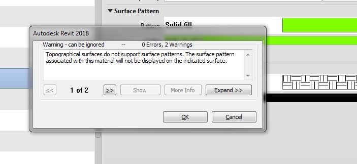

Hi!
Is there still no way in Revit to have a surface pattern on topography. Maybe any cheat way? 😉

loboarch
Nothing has changed with this situation. Surface pattern is not possible on a toposurface element in Revit.

There has been no change to the toposurface element. It is not able to display surface pattern.
For plans, you can use a filled region to indicate a surface pattern. With the background set to transparent the contour lines of the toposurface will come through.
for 3d view you have subregions and can use a shaded display type with different colors representing the different surfaces.
