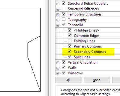

Visibility settings:
jvolanski
I already tried this. My issue is about triangulation edges, not contour lines. Un-checking the box you indicate has no impact whatsoever on triangulation edges being visible.
