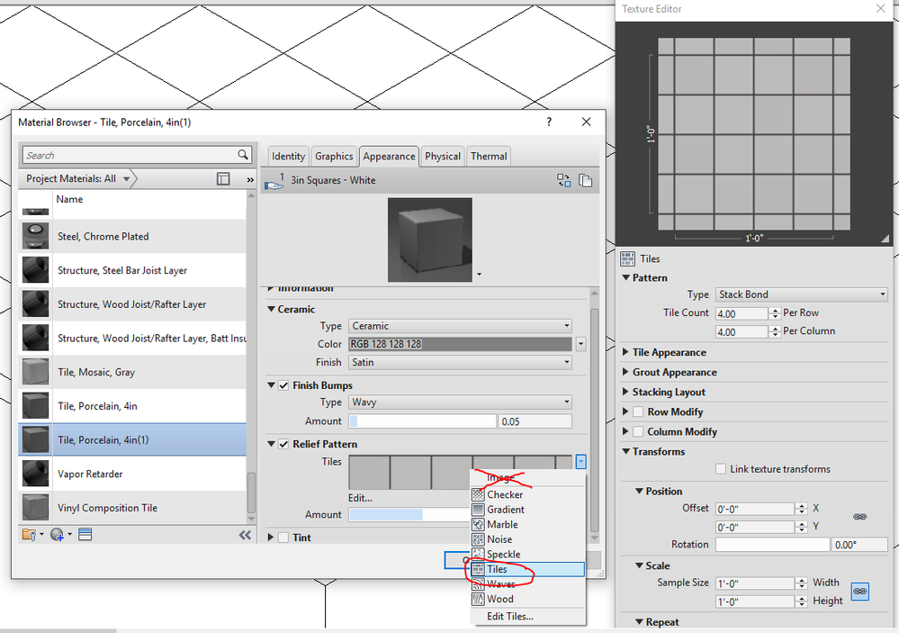

I have this issue with Revit 2017 that i could not solve in all possible ways.
The material itself has 30x30 cm relief to show as ceramic tiles.
In realistic view it shows right (check image ss2) while in render it shows weird (check image ss)
I have tried changing material asset and changing material and using image bump instead of tile bump and still the same issue.I made sure 2 floors are not overlapping and not any other floor is overlapping in other phases. i tried as well auditing the file and checking online for solutions there are none.
Please get back to me ASAP. THanks!!

I have tried all kinds of solutions and i have used an image bump and the same problem applies.. check the image attached and you will see that the bump creates 2 bumps offset slightly from each other.. i can not seem to get rid of this problem whether it is an image bump or a tile bump..
I don't think anyone understood the problem correctly, i'll explain more:
You see in the material editor(image rrr) the material appears correctly, only when i render it appears to have 2 overlapping bumps.
Is it clearer now? so again in the material editor the sample render seems perfectly fine and in the realistic it is fine, the problem appears when i render..

I think the procedural mapping function (Bump, Relief) is broken in 2017.  It could be a side effect of changing the rendering engine from Mental Ray to Autodesk Ray Trace.  Or it could be due to something else, I don't know.  I did a test in Revit 2016 with the exact settings and it works perfectly (see image below).
Until they fix it (hopefully), I suggest you not using procedural Tile, but an image for Bump or Relief mapping, as demonstrated in my previous post.

You are using an image for bump or relief pattern.  He is using the mathematical Tile algorithm.  They are two different things.

Found your tread somewhat similar to a problem that I'm having in Revit and 3d Max procedural tile map. I love the ability to generate randdom tile diferences but could not find what parameters to change to get the looks as in the image attached. Is it really impossible because of some kind of software limitations or am I missing something?
The closest I got to what I wanted in Revit, was by not tiling the tiles vertilly. If I uncheck vertical repeat the render image is correct, but as soon as I check it, as I should, the texture editor shows me the wanting result but the render image shows me something diffente (not want I pretend). That really seams to me that's a bug.
I can confirm this behavior.  Looks like a bug with the procedural mapping.  For the time being, the workaround is using Image mapping.
