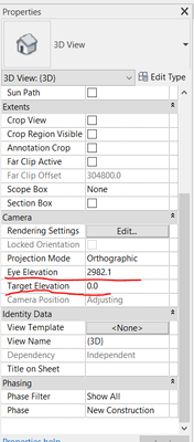

Hi @Anonymous
Deleting and recreating the 3d view will resolve
But if you don't want to lose your eyesight, check your view properties, the "Eye Elevation" and "Target elevation", if the numbers are large, change them and then rotate.
Or click on the viewing cube and then rotate
