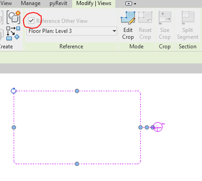

Mike.FORM
Why are you using text for this? Why not use an actual callout and check the box 'Reference Other View' before placing and then select the view you want it to reference?
You could also use a View Reference Tag.
