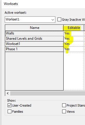

Revit will ask to Relinquish if any  of the worksets are " Editable: Yes"
If you keep all the workset as " Editable : No " then revit wont ask you to relinquish anything
after saving to central..
Give it a try and you will get a clarity how workset, editable and relinquishing works..

I ran into the issue where it continuously was not relinquishing one of our user-created worksets.  Everything was set to "not-editable", and the "Borrowed Elements" checkbox was checked, everything else was greyed out.  When I changed the workset to "editable", then opened the sync dialogue box, the "Borrowed Elements" checkbox was no longer checked (because I changed myself to Owner, rather than Borrower), and the "User-created Worksets" checkbox was no longer greyed out, and unchecked.  By checking the checkbox and synching, I once again went back into the worksets dialogue, found that specific workset that wasn't relinquishing as relinquished, and changed back to "non-editable".  It may not fix the problem for everyone, but it seems to have fixed the problem for me.
I am on Revit 2021, with a BIM360 model, for those wondering.
Hope that helps someone who runs into the same problem.
