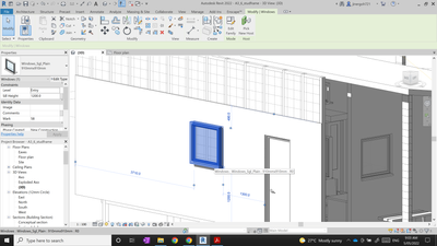

How to model a steel stud wall in revit according to diagram shown below?

Curtain Wall with Studs as Mullions and empty space between studs as Empty System Panels.  Or, use Beams and Columns.
Here's the gist of the Curtain Wall approach:
...then start adding Grids/Mullions.  Going to be a lot of work though. It would be even for the best of us.
....FYI: If this is typical work for you, there is better software. Strucsoft, AGACAD, etc. Expensive though. Like Revit-Expensive.

But I stucked at this, the curtain panel is solid instead of empty like in a stud frame. I followed the settings, not sure if I missed out anything.

Set the curtain wall type to use Empty System panel type.

Not that I want the outer part to be Insulation layer in between wall panels, but empty air for inside the windows, how can I fix it up?
Jiner
Message 12 of 21
- Add curtain grids around the window opening
- Tab on each grid segment inside the opening and Remove segment from ribbon menu
- When done you will have an opening without any studs inside
Message 13 of 21
jinergoh721
Look there's some glitch here even though I put empty panel, may I know how to fix it.
Message 14 of 21
Use Empty System Panel, not Empty Panel.  They are different and the former works for non rectangular shapes but the latter does not.
