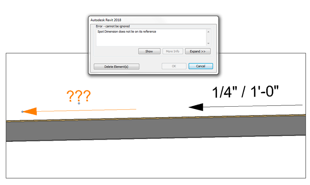

Hi all,
Has anyone run across the issue of spot slopes not offsetting properly from their references?
Typically when I place a spot slope I'm able to move it off the element I'm dimensioning (i.e., roof or floor) so that you can read it- but Revit currently will not let me do that at all, when I move the arrow it loses its slope annotation and I get an error message - see attached images.
Doesn't seem to pay any attention to how I'm setting the 'offset from reference' value, either, I've tried changing that- it places the spot slope directly on the element and won't let me move it without forcing me to delete it.
Also- I've been using spot slopes all over this project, with no issues until today. Already tried restarting, etc. to no avail. Any thoughts/suggestions are appreciated, I'm tearing my hair out over here!this is where revit wants to put the slopethis is where revit wants to put the slope...and what happens when I try to move the slope annotation. :(...and what happens when I try to move the slope annotation. 😞

@barthbradley and @ToanDN, thank you both for digging into this with me- the most likely culprit (or at least the explanation that makes the most sense to me, given how  Revit tends to do some odd graphic things with section cuts at angles, i.e., no grid lines unless they're intersected at 90*) seems like the angle/shape editing of the roof relative to the angle of the section cut, which is frustrating because it's not something I can change at this point. I tried the workaround of changing the slope from negative to positive, which helped in one case but not another (also not 100% sure why this would matter- we set the roof slope based on where we knew we needed the high point to be, which doesn't seem that strange to me...but hey, I'll try anything at this point.) For now, I'm just leaving slopes off the sections that I can't get to annotate properly. File this one under the department of wasting time...

@ToanDN I can place them just fine- they just won't allow me to move them...and tabbing to select a different part of the assembly was the first thing I tried, it was super finicky for me and would only allow me to select one spot (usually at the bottom) for the slope in some cases. I'm at a loss as to why it works for you but not for me...gremlins I suppose.
I generally agree with you that it's not necessary to show slope in all details, but for a smallish house project it's nice to show in multiple locations. We generally like to show slope graphically in both roof plans and overall building sections. Since, in theory, you're just tagging a property of the assembly, I'm not sure what the downside is to having it called out in multiple places (not a coordination issue or something similar, imo).
