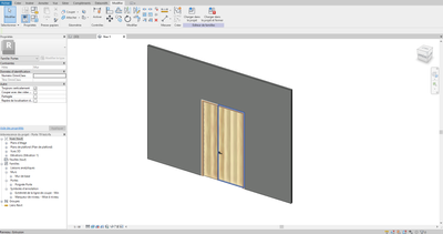

I'm currently using families for doors in a Revit project.
When I load the door inside of the main project, the door is in one block and I can't access all the sub-parts.
The problem is that this is for exporting into Unity and I would like to interact with the doors, so I need all the components separated.
Is it possible to split all the parts in the main Revit project?

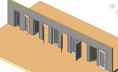

Message 8 of 10
@timothe_watteauKU8ZR wrote:
For example I'd like to be able to rotate the door panels, but right now in the Revit model they door is in one block so when I export it, I can just move and modify the whole door and the door frame as a single object.
"Rotate" the door panels?  "Rotate" how?  You mean rotate the door panels about their hinge axis?

Message 9 of 10
It was absolutely what I was looking for !!
Thank you so much!
Message 10 of 10
Yes it was my problem, now solved
