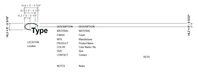

We are trying to create a "smart" annotation that carries lots of information about the finishes we are pointing out. This annotation will be an oval on plan but the box with all the information could be toggleable to show so that we can place all these boxes on sheet and display the info how we want to. Trouble is that once we created the togglable box it messed up the leader and now the leader does not come out of the annotation. Does anyone know of a fix?

@TripleM-Dev.net Fantastic! We are one step closer but still have issues. If you look at the screenshot below, I was able to associate the lines to reference lines in the family and make those lines all collapse down into a tiny box when the oval is set to visible. But there are still leader line issues. As you can see they leave a gap above the masking region. The gap moves up if I move the ellipse up. I can't understand why. Deleting the ellipse does not help and the gap remains. I cannot figure this one out...
