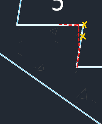

Hi all revit master,
I hope someone can help me
i have a stair model with the slanted riser and vertical ending on top of it,
i'm using basic slanted option in stair
can anyone have a hack or cheat how to get the job done, i just spend 6 hours do nothing about this
Thankyou
119 Views
arq_42
You must create a profile family with the height equal to the height you need to maintain the vertical. The length of the profile will be equal to riser's thickness.
Then, in the stair, you must select that profile as the stair nosing and click on Slanted riser.
The stair nosing length will help you modify the riser's slope.
The height of the nosing will be the vertical part of the riser

aditya_wZVJYS
Thankyou man
