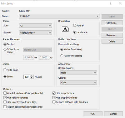

Hi all,
I just wonder anyone know how not to print sketchy line
My revit model screen display no sketchy line as screenshot below
But it printed all jitter and sketchy, I have checked graphic options sketchy line are turn off.
is there any way i can turn off the sketchy effect in printing ?

You might have turned on thin lines so Revit view looks sharp.  Turn off thin lines and see how the view actually shows.  Additionally, the view scale is very small 1:400 so expect low quality if you print 100%, and I don't even mentioned if you might have printed to raster.

I have tried
1. changing scale of the drawings (1-200, 1-100, etc)
2. linking the view in a new template
3. changing multiple pdf plotter (bluebeam, biopdf, etc)
however the issue still the same. The printed pdf always have crooked line and is different from screen display (refer  2 screenshot below)
There are certain setting driving the graphic for the file, but i cant seem to find what controlled it

I did not change any Revit print settings.
... only change PDF printer to High Quality.

At least now i know is not a file issue, I will try to find biopdf setting to match the adobe pdf setting.
I set it to 600 dpi, but the graphic still not achieving what you have...

600 dpi is not high quality.  Adobe PDF High Quality Print is 2400 dpi.
