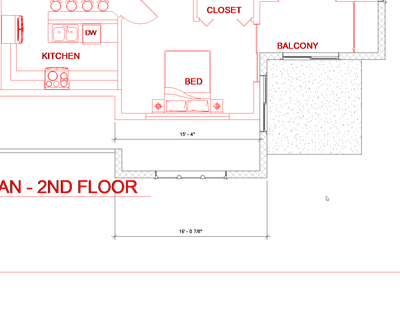

I had modeled my design in autocad before I started designing it in revit. I had all the dimensions perfect in autocad.  I am teaching myself revit and started doing the floorplan using the wall function in revit. After I have spent over 50 hours on this trying to figure out all of revits functions, I realized that the dimesioning does not work the same as auotcad, so now all of my overall dimensions are off. For example, I wanted a wall to be exactly 15' 4" from the outside of the building, since I am using 8" masonry in revit changes the dimension to 16'-8 1/4". This is so frustrating because now my building does not fit into my property lines, any advice on what I am doing wrong?
I have determined that it is because it measures from the centerline, so any advice on how to account for this or change the setting?
Even in this picture, I made this wall 15'4 and it changed it to 15'-11 3/8

Autocad vs Revit. The Autocad dimensions are what I am trying to achieve, but when I type in those numbers when doing the walls I get these dimensions instead

They are not the same.
Here's your DWG Linked into Revit.  The DWG is RED in the screenshot.

like this, when i activate the 'WA' command and put in a new wall link

Looking at your Revit and your dwg...it appears that you went flat out on walls placing them using Location Line at wall Centerline...Next time you are placing walls chains by typing in Dimensions (Similar to what you would do in Autocad)...it might be more convenient to .
  1. use Location Line at Finish Face
  2. When you type in length, type in 15 space 4 ... no need for the ' & "
It is sad that you will have to resize all at this stage

yes i believe this is the problem. it is very sad, I am brand new to this program and teaching it to myself. such a big learning curve. about 50 hrs of my life down the drain, but good learning lesson. thank you so much

Just as an FYI: these symbols indicate the exterior face of the wall (which is currently oriented towards the interior). If you press it, you can change the wall's  orientation.
