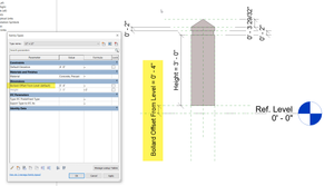

Create a Shared Parameter to control the offset distance and pull that Shared Parameter into your Tag Family. This will require some work in the Family as well as reentering "offset" values in the Project for each Instance of the Family, so it won't be a quick or painless remedy.
Here's an example for you using the Bollard Family, which is a Site Family available in the OOTB Content Library.
That was easy the easy part.  How many instances of your family will you be overwriting with your new and improved version? That's where it could get tedious. You'll need to enter each of their offset values manually into the Shared Parameter Field that controls the new version's offset.
