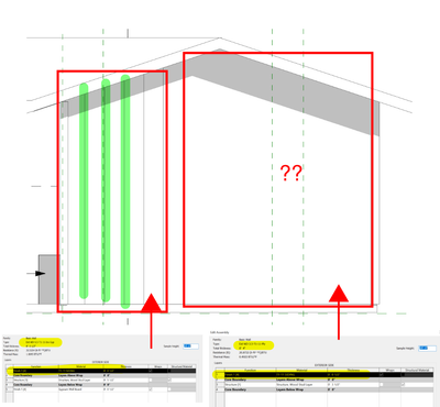

Exterior wall finish pattern missing on one wall
I have two similar walls with the same exterior finish, but one is showing the siding pattern and once is not.  My goal is to have the same sliding finish on both. See the elevation below. If anyone has any ideas, please let me know.
Thank you.

Are they oriented the same?
One may be painted over so Remove paint see if it helps.
Are they under the same phase?

Hi @micah
When you select the wall in plan view, the Blue Flip arrows will appear on the "External" side of the walls.
Can you confirm the orientation of the walls is correct?

I already did that they are facing externally, which is correct side.

Does the Surface pattern show if you turn off shadows?

Maybe a rule-based Filter acting on one and not the other?
Heck, could be any number of reasons.  Let's end the guessing game. Post the file.
