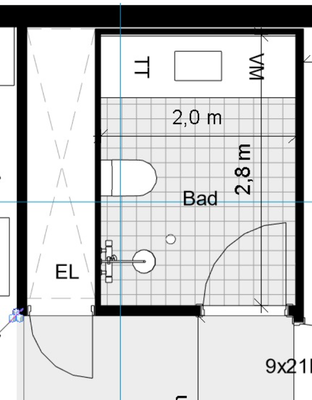

Hi All,
I am preparing some apartments' floor plans and I have been asked to show the lowered ceiling in the floor plan. It should look as below. The lowered ceiling , which are just in the bathrooms in this example, appear in grey .
ec9d61a4-17ea-40d7-ba6e-d6405f9abe2d.jfif
I have been told to create a floor plan and overlap a ceiling plan which is showing the lowered ceilings (Filters hiding everything besides the ceiling, which have a grey override).
However,  I am not reaching the result wanted so I am asking for your help. Unfortunately I can not share the revit file.

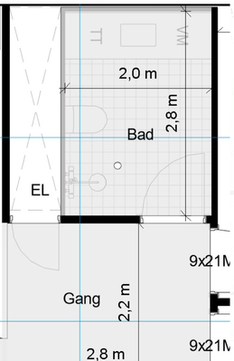

If I place the ceiling plan above the floor plan in the sheet, this is how it looks like: the walls under the ceiling (which are part of a linked revit model) appear greyed out.
If I place the floor plan above the ceiling plan the furniture is not greyed out.
I need to reach a result as the example above (1st image)  : a grey ceiling pattern which "covers" furniture, but not the walls below.

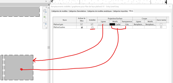

A compromise to the grey out linework of the plan elements can be achieved by applying a solid black color with a high level of transparency to the ceilings in the RCP.
In the image above:
  • The grey fill is a 100% solid black + 75% transparency. To make the ceiling lighter, increase the transparency;
  • The ceiling projection lines are replaced by hidden lines as they are to be viewed in a plan view;
  • The two filters will have the same but opposite rules to select the dropped ceilings in the first line and select all ceilings but the dropped ceilings to mask all others.
Here is the result:
  • PLN = plan view with the wall, columns, etc with a solid black override;
  • RCP = reflected ceiling plan view with everything but ceilings turned off and two filters for
  • SHT = sheet view with the plan view placed first then the RCP view placed aligned on top.
In the top left part of the image, the linework is almost but not quite 100% process black. There lies the compromise if the printing process for the plans is not too precise, no one will notice but you.
Hope this answers your question.
-luc
