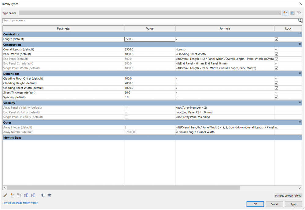

Please can some one look at the attached family and give me some tips on how to fix it. The family is steel sheets where you choose the length and it will tell you how many sheets are require ( sheets are 1000mm wide ) however if the length is less than 1500mm the family will break and gives an error of Parameter sheet count has an invalid value . The family is made up of has singe sheet and then another instance which is the arrayed sheets. I want to be able to have a cladding length of say 500mm and a sheet count of 1, if the cladding length goes over 1000mm the the sheet count will change to 2.

Actually, the formula for "Cut Panel Width (Array Spacing)" is totally wrong. Doesn't factor in that the MAX Panel Width cannot exceed the Uncut Panel Width.  Basically, the family should include an End Panel that fills in the leftover space.  In my example using 86'-0' Overall Length, there would be eight (8) 10'-0" wide panels in the Array and a separate 6'-0" wide End Panel.  Easy to correct though  -- after a nap.  he, he.
...or, in lieu of End Panel, a MAX 10' panel, which is probably more to your point.

Sorry, I'm late, not to fixe the issue, only to explain to OP what happened there:
1. at 1500, 1500/1000=2, at 1499, 1499/1000=1. to fix it, and roundup()
2. you cant have an array with 1, even when it is hidden. So make it 2.
Also, you can simplify some formula as well. Good luck.

bin
Don't have 2019, sorry about that.
1. I was having a bit of trouble to understand that formula, so I changed that and mike it a bit simpler.
2. In the original family, the extra 1mm is used so it will not fail the extrusion when it is 0mm left for the end panel. But this will cause the whole family 1mm longer than the overall length.  So I just changed them a little bit so the end panel stays at 1mm, but hidden.
3. In your original family, the visibility of the single panel is not(array), which means it will always visible when the overall length is less than 2* panel width. Not sure if this is the intention, I just changed it...
4. I think some of the parameters should be Type instead of Instance.
Other than that, nice work. 🙂
I have attached the 2020 version.
Message 34 of 36
