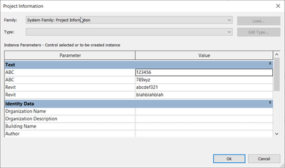

Any idea why a shared parameter loaded into a project and categorized as Project Information is not Editable?
Its just a Text parameter. Creating it as a Project Parameter works fine.
What is strange is that I have loaded 4 parameters that are all the same (txt, Project Info) and 2 are editable and 2 are not?

As I understand it, the OP is saying that 2 of the 4 the Project Parameters he created from Shared Parameter Text File(s), and assigned to Project Information, are NOT editable under Project Information - meaning that he cannot input in any text into its field.   It's empty.
That is what is strange to me.  Even if the parameters were the same name, but different GUIDs, it would still be strange to me.  I don't have any like issues - as my screenshot proves.
Message 8 of 14
hubbardFJXGT
That is the issue. Cannot post the file, but here is the screenshot of project information. Is there a restriction on using the word Revit in a SP? I renamed the parameter in the file deleted and reloaded and it works? Tried 123456 for instance and its fine. I was unaware there are any naming restrictions as indicated by the posts above where you can have 2 SP with the same name but different GUID

Message 10 of 14
hubbardFJXGT
Well then I am stumped. Revit Ver. is not editable in any of the RTE or RVT files I load it into. I have even deleted the SP entirely from the file and recreated it still, still not editable in any of the projects under PI.
