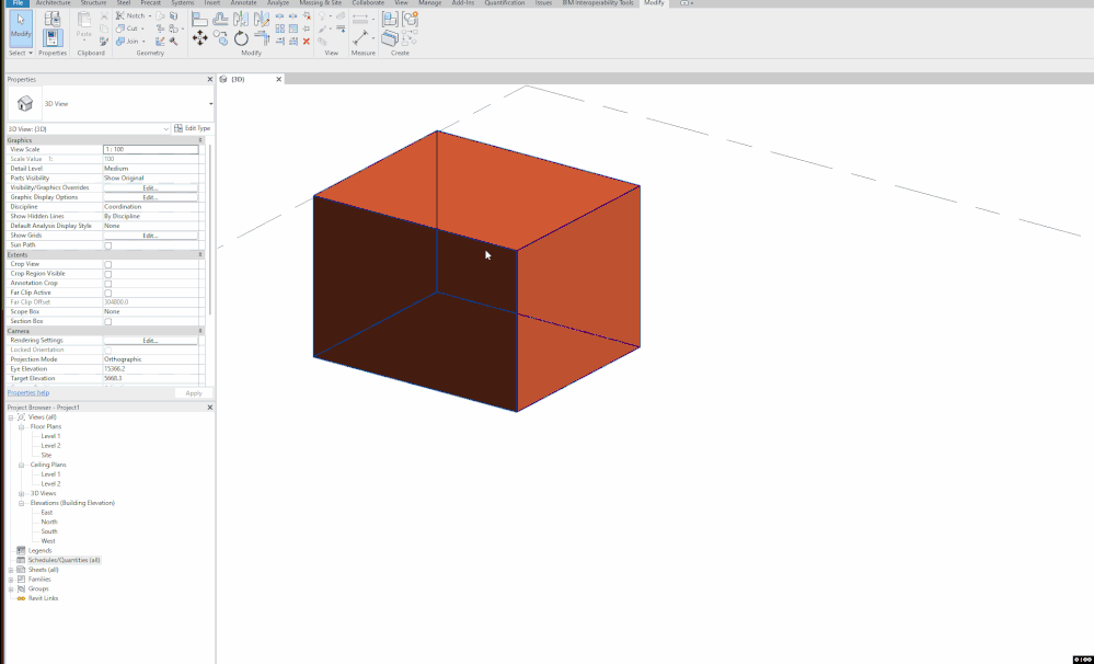

The parameter you are using must be a shared parameter. You will need to edit the in place mass, add a shared parameter for material, then associate it with the built in material parameter of the formed mass
