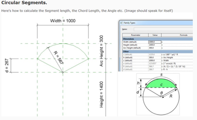

Message 4 of 11
Sounds like you need this information:
More on formulas here:
Revit Formulas for "everyday" usage - Revit Forum
