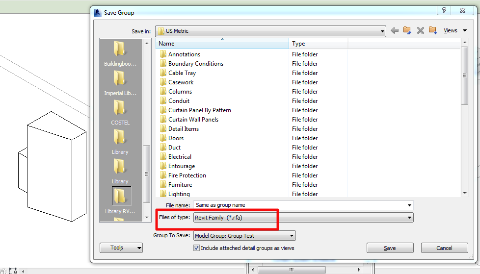

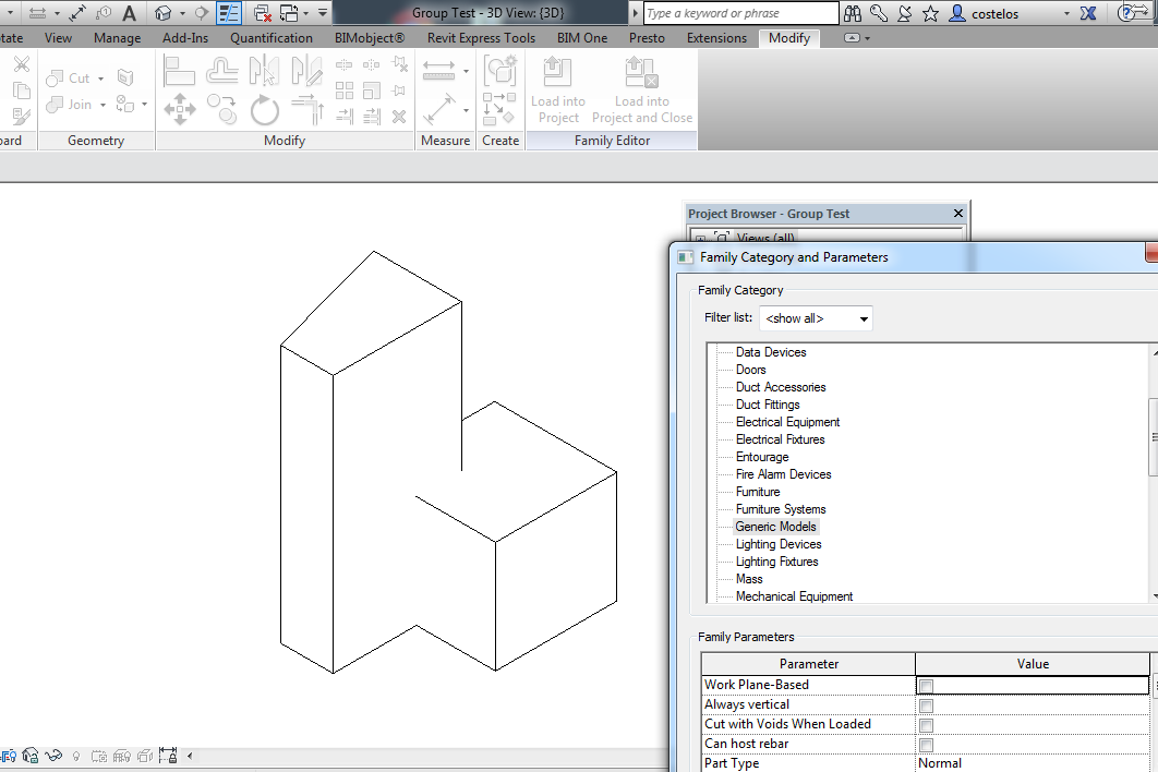

If you have a Component Model in Place and you want to turn it into a Component Family so to can use it later in other projects,you have to make the following steps:
  • first , select the Model in Place Model > Edit in Place
  • in Edit in Place , select all the subcomponents and make them Group
  • stil in Edit in Place, select the Group and from Application Menu ( R) > Save As > Library > Group > Save Group - you will see that you have the option to save as File Type : .rfa  - save it into a folder
  • Finish model
  • from Application Menu (R) > Open > Family > open the new created family - you can then load into any Project

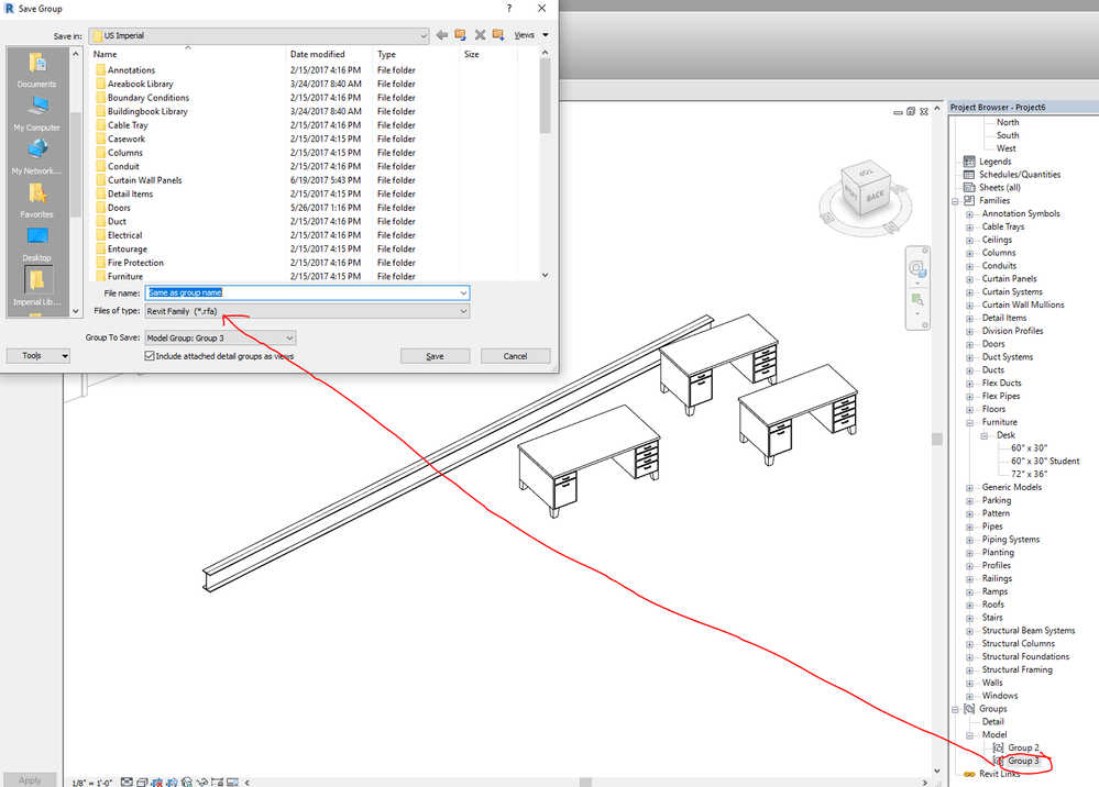

I have seen numerous blog posts etc. that detail the Component In Place > Group > Save As > Library > Group workaround.  It seems to work from many people, but not at all for me.
I have an object made up of 4 separate model-in-place extrusions.  I have made a model group from these pieces and named it in my project.
 However, when I get to the Save As step, I have zero option to make the new file a .rfa Family.  I can only make it a .rvt Project.  I have no other options.
Can someone please tell me what I'm doing wrong?  Thanks in advance.

When you make the Component Model In place , you must make all in one Component (under One Name) even if there are more Extrusion, sweeps and other shapes.Join them together working only in one Component. Do not make more Components and then join them.
Without Finishing Model , make Group and Save As> Group -  the option of saving will be for .rfa
Constantin Stroescu

Hi, Alfredo, and thanks for the prompt reply.  What you are describing is exactly what I'm trying to do.
I have a custom casework piece that is modeled in place within the larger house project, as a model group of in-place components.  For a variety of reasons I would like to export or convert that M-I-P group into a family.  I tried using the method described above, but when I get to Step 3 ( the "Save As > Library..." step) I have no option to save the group as a family, just as a project.  Clicking the little "File Types" drop-down gives me only the .RVT option.

As Constantin explained:
So if you've already created and finished you In-Place family, first select your in-place family, then edit it in place and then make & save the group while editing. Then you will have an option to save RFA. If you aren't editing you'll get only RVT option.

As constantin explained, does not work.
>make group of selected elements
>Save as group
>.RVT is the only option
After following precisely what each comment above has said, none of the above posted answers seem to work.
