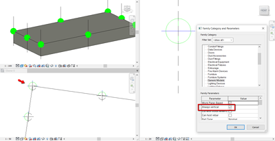

Hi,  I understand how frustrating and issue like this can be.  I'll be glad to help,
For the families which do not rotate:
  • What is the family category.
  • Are you trying to rotate in Plan, elevation or other view?
  • When editing the family in the family editor, Is "Always Vertical" checked?
If it is selected, does deselecting "Always Vertical" and reloading the family allow rotation?
If the "Always vertical" checkbox  is selected in a specific model's generic family, then the rotation of the family in various directions are locked. In the screenshot below notice that the axis of the family is not aligned with the orientation of the slab after the rotation.
If this does not help, Please post the family and a screenshot showing the view.  This would help understand the conditions where this is happening.
