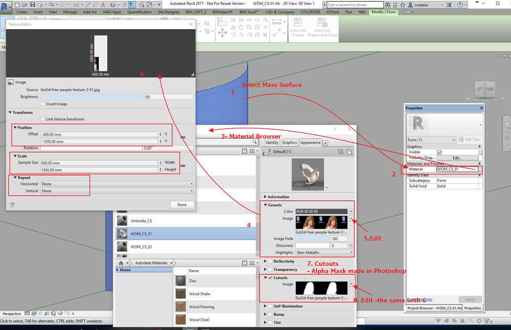

I've made distinct families - Mass Elements- Surface ( I've used a curve surface in order to make easier to work with camera that has to be perpendicular on the map)
Every Family is basically the same object but with different materials ( people or tree maps with alpha mask). So, every people or tree is a distinct family in my library.
how it looks in Realistic View display and the settings made in family editor-Material Browser:
placing camera and Mass Family in Project:
and in render in camera View:

we use two bitmaps edited in Photoshop :
  •  A-the first one is with the image in RGB colors
  •  B-the second in in Black and White - where black is transparency(level of greys give semi-transparency) and white opaqueness - this file has to be the same size and resolution as file A. Normally B is worked in Photoshop from A
ABUSINESS #4.pngBUSINESS #4_mask.pngB
I use for the first bitmap(A) either a .png or a .tiff file because they already come with incorporated alpha mask. Such a file can be used directly to insert in rendered image usually in Photoshop  or use it in a Revit Sheet  with a linear drawing (and not only ) as shown below :
  • When using Entourage Families -as shown in my previous posts, Revit needs two mappings for images with transparent background.
  • In Material Browser >Appearance we have to place two bitmaps:
    • one for Generic -A
    • and the other one for Cutouts -B
  • Transparency mapping is another choice ( it is used in 3dMAX) , but in Revit, Cutout option a is better one.
