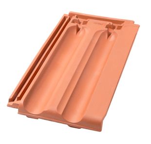

zs-17
The below type of roof tile is the common in my area. any way to apply it on a roof in a condition the horizontal lines will be aligned is acceptable to me; if so, you need need to send me relative steps. By the way, can I save sent screencast in my computer?
