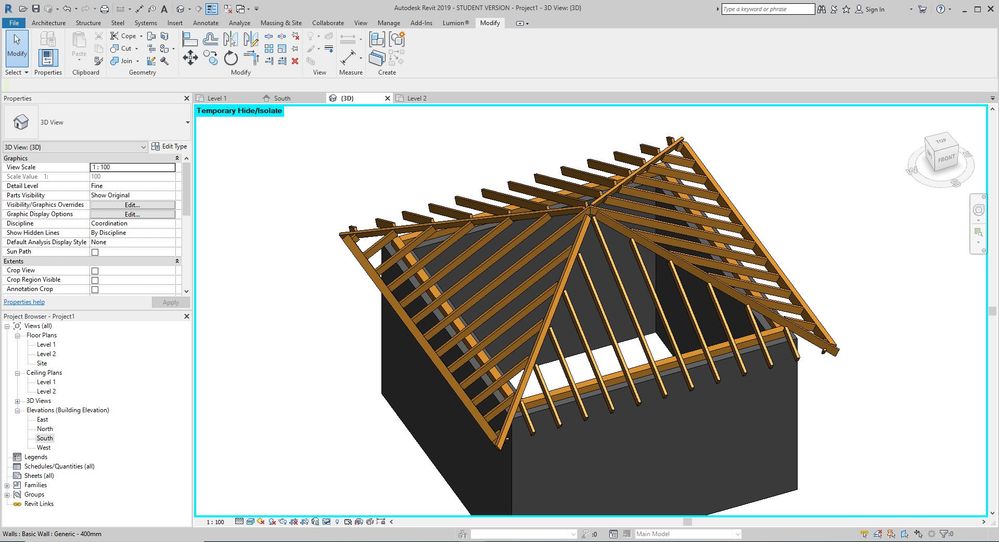

Hi Everyone
Could you please help me with creating a normal "Roof Structure in Revit" I'm trying to show the wooden construction Plans / Sections etc. Do you know any tricks to construct an accurate Roof Structure? I will upload some photos to show you what I did exactly but in my option it's really childish to represent it that way. I'm trying to have Normal "Rafters" joined with "Ridge Boards" and then I wanna add the "Purlins" to it to show that it's holding the Rafters and I want it to be connected with the "Wall Plate". I had to use base offset for the Roof to connect the Rafters to the Wall Plate.RepresentationRepresentationBad Joints / No JointsBad Joints / No JointsBad Rafters on the corners(And it's Angled, it's not 90 Degree)Bad Rafters on the corners(And it's Angled, it's not 90 Degree)Rafters not connected with Wall PlatesRafters not connected with Wall PlatesBase Offset is used to connect the Rafters with Wall PlatesBase Offset is used to connect the Rafters with Wall Plates

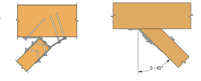

How do you want to attach your Jack Rafters?

bin
You can try this:
Model 5 columns in your model, one at each corner centered in the wall core, and one in the center of the room(roof). Attach top to the roof.
Then create rafters and top plates(structural framing) using 3D snap to the top points of the column. Use the Z justification if required.
The  next step is to create the beam system for the joists. Before creating each beam system, you will need to pick a work plane. You can pick the face of the roof.   Or you can create a joist from the center point of the wall plate to the top point of the column, then pick the top or bottom face of the joist.
Now you have the work plane picked, just need to pick the edge using pick beam(forgot the name, not pick line, similar to pick wall).  Pick the joist, the rafter and the wall plate. ( rafter, rafter and wall plate if you are using the roof as work plane)
Once all done, you can adjust the Start or End extension something to adjust the length(never drag the point). Or just drag the shape handle(blue triangle). Then you can use the Notch tool to join them.
After you finish everything, you can demolish your columns to make them temporary.
I think it should work. Its Sunday morning and I’m still in bed. Please let me know whether it works or not. Thanks.

Personally, I would just cope the jacks at the hip rafter and zero out the coping distance.
...or use SST LSU Adjustable Rafter Hangers and leave 'em be.  😉

bin
Yes you are right, what is notch? I was talking about Coping.... That's why I should not reply in bed.

I don't get your columns approach.  Can you post a picture showing what you mean?
BTW: Simpson LSU4.12:
https://www.strongtie.com/facemounthangers_engineeredwoodconnectors/lsu_hanger/p/lsu#Drawings
Just having some fun here.

bin
A quick one:
Message 14 of 53
